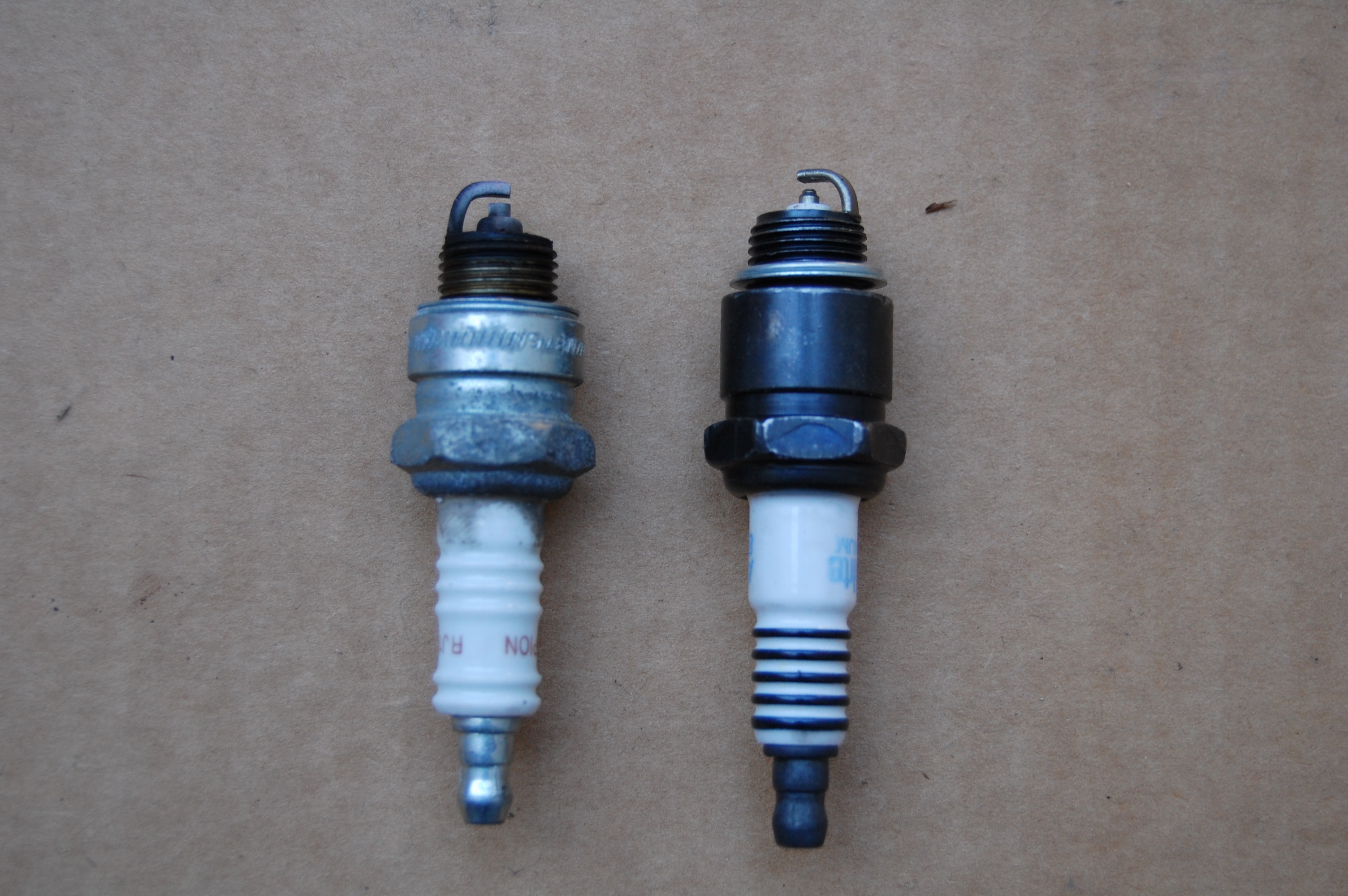

I replaced the champion spark plugs on my 69 6pak bee with autolite 85 platinum plugs this weekend and the bee did not like them! I noticed a hesitation right when I started it up and every time after that. The biggest thing I noticed is that I could smell the fuel from the back of my car, in fact, it stunk up my house real bad (the drive way sits right in front of the house and I have an attached garage). Also, I noticed that when I turned the car off, it would shake a bit, some people call it "dieseling."
So, I'm going back with the champion plugs that were on there before. I just thought I'd share my experience. I also included a picture of the 2 plugs for comparison.
Juan

Sounds like you have a cracked plug or two. I also heard that they just started making Autolites in China. May be a sign to go to NGK's in the street cars. Juan check the plug ceramic area. Also what ignition are you running. FYI I put a set in the 71 RR I ran this past weekend, I had no issues.

Hey Ralph, I have the elec. ignition box with the orange street box. I'm gonna go back to the plugs I had before as they seem to work fine, but I'll check the new plugs for cracks when I remove them. What type of ignition do you have on your RR?

Cool beans, thanks for sharing. I put a new set of Y12 champion plugs back in and it seems to be working fine so I'm gonna run with it.
