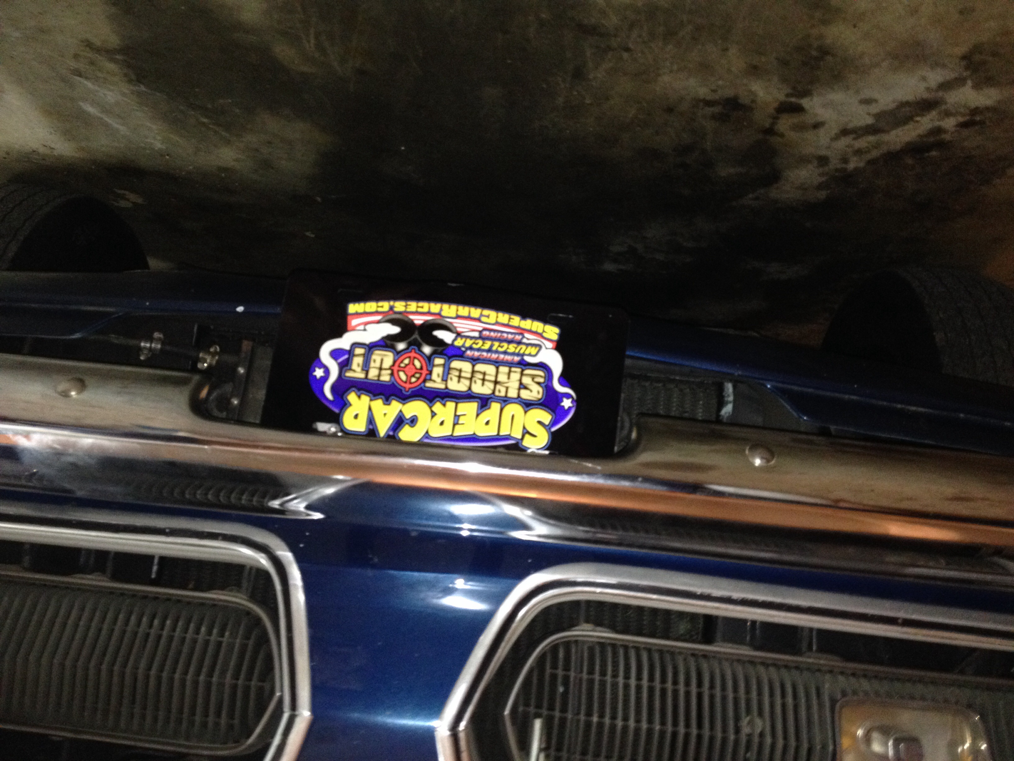

Starting to open
PostPosted: Sun Apr 30, 2017 3:57 pm
Fully open
PostPosted: Mon May 01, 2017 6:16 am
That is pretty cool. I would never of thought that it would open up so fast plus neat idea on rigging it up to time it

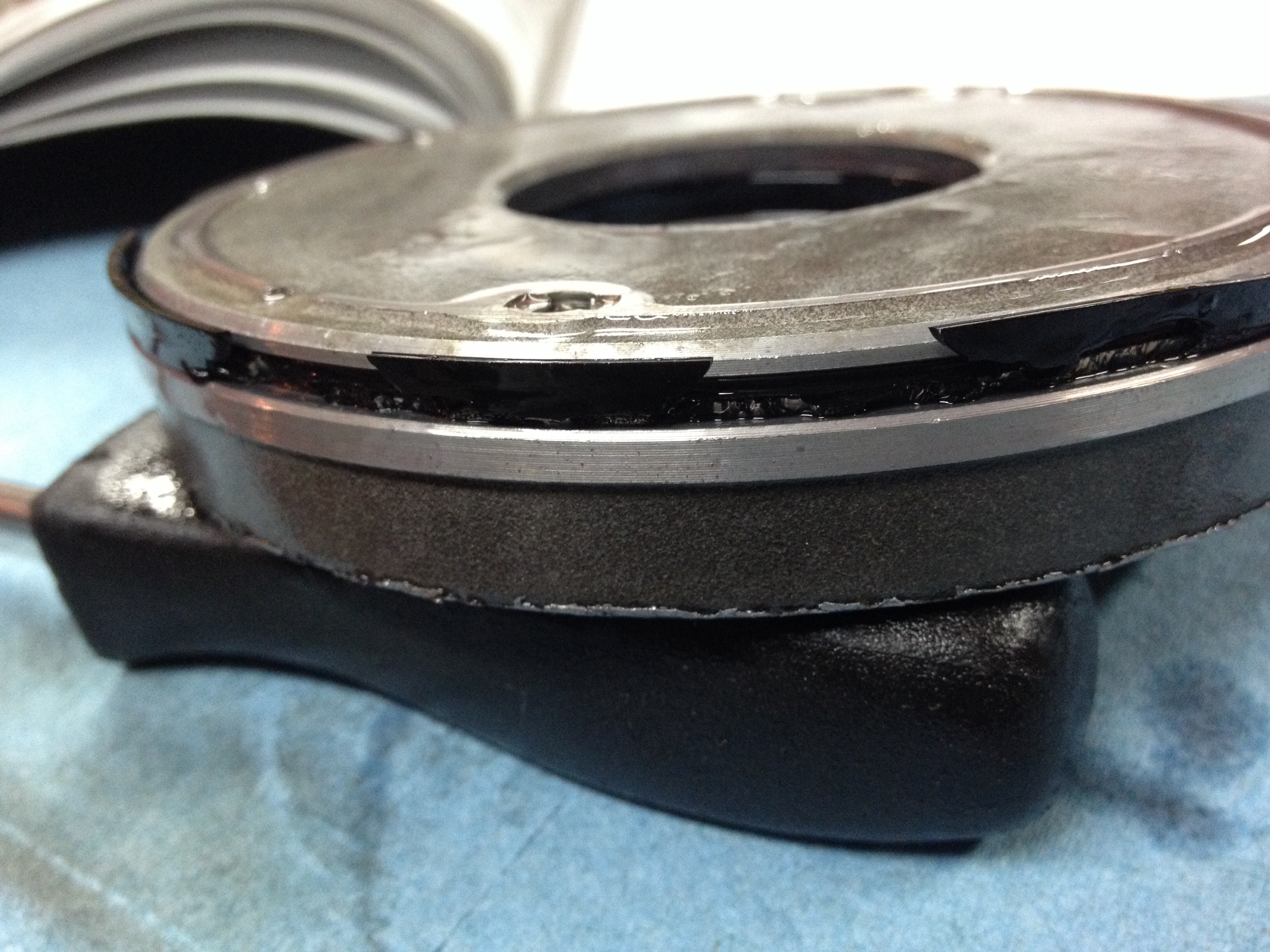

PostPosted: Tue Aug 29, 2017 10:19 am
Bad seal! It's tough to get seals to behave! This is the rear clutch piston seal.
image.jpg [1.92 MiB]

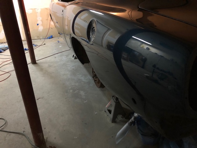

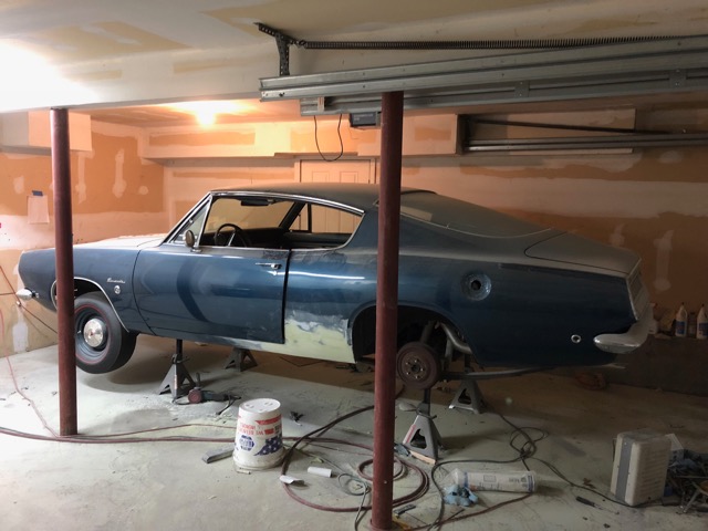

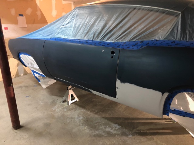

PostPosted: Sun Apr 01, 2018 11:03 am
Mid body work.

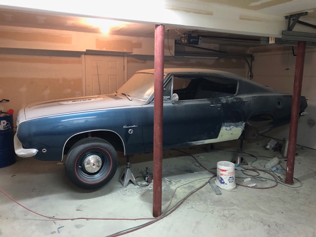

PostPosted: Sun Apr 01, 2018 11:05 am
One more
PostPosted: Sun Apr 01, 2018 11:09 am
I used the plastic wrap that is supposed to be designed for painting. It's supposed to not allow overspray to blow off, not true. You should still use paper then plastic.
PostPosted: Sun Apr 01, 2018 11:11 am
After cut and buff.
PostPosted: Sun Apr 01, 2018 11:13 am
All done.
PostPosted: Sun Apr 01, 2018 11:16 am
