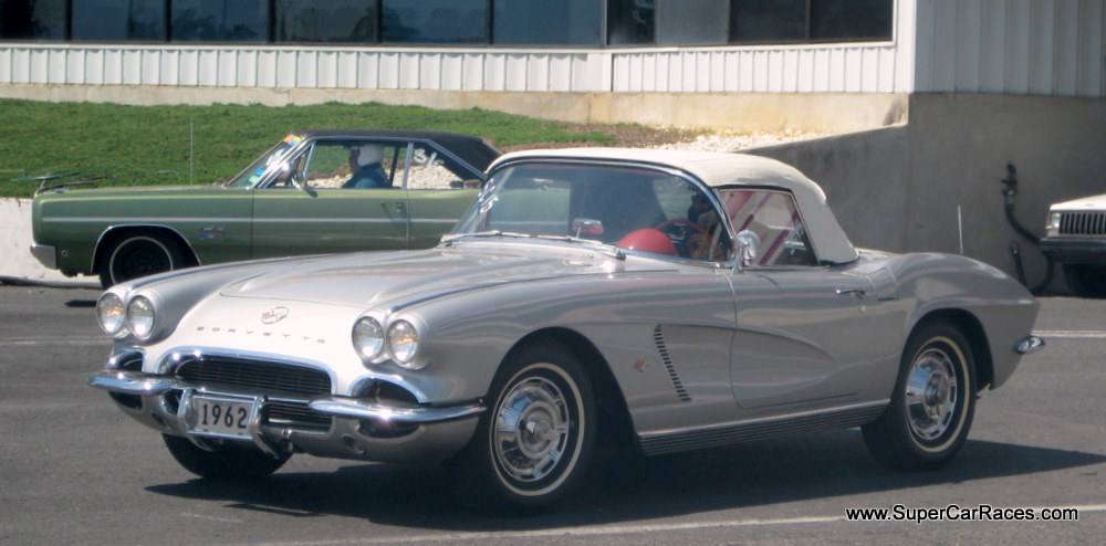

Very nice! Love the black/red combo.
Perhaps we can go head-to-head some day?
Jack
