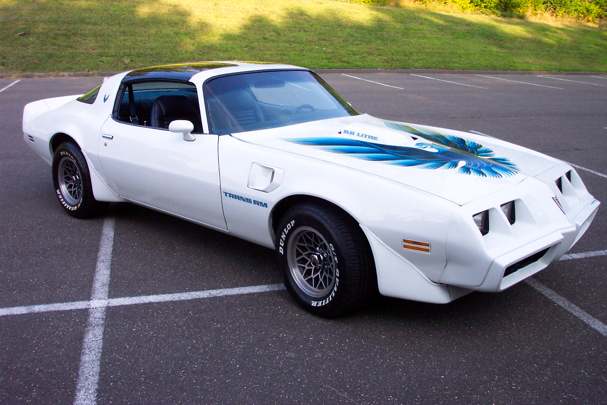

I built one of those 403's once. Pontiac called it a 6.6 LITRE though. :mrgreen:
