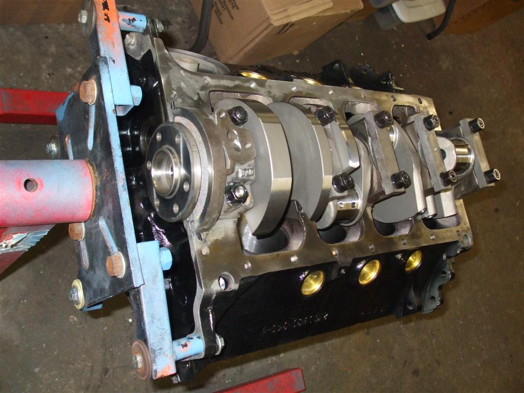

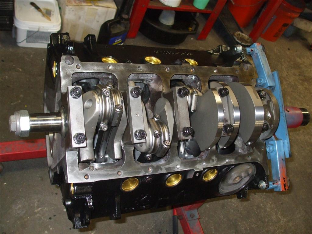

Assembly started with crank install of course. Bearings are 1/2 groove with the exception of #3 and #5. Clearances are right on! :aok The machine shop was nice enough to paint the block black but will soon be a nice shade of 71/72 up Chrysler blue as seen on the engine stand. I might have to change my pre-paint block prep tecnique which is to fill up a Binks #7 spray gun with laquer thinner and hose the whole thing off. If that black paint starts to lift, it will sure be messy.

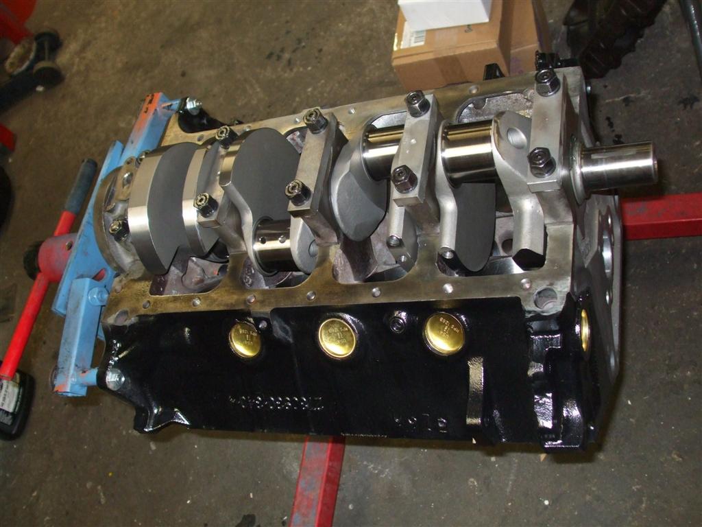

You will notice the very unique main cap "straps". I've never seen this before but other than removing a little of the cap to make a flush pad for these to sit, I don't see any reason to do any different.

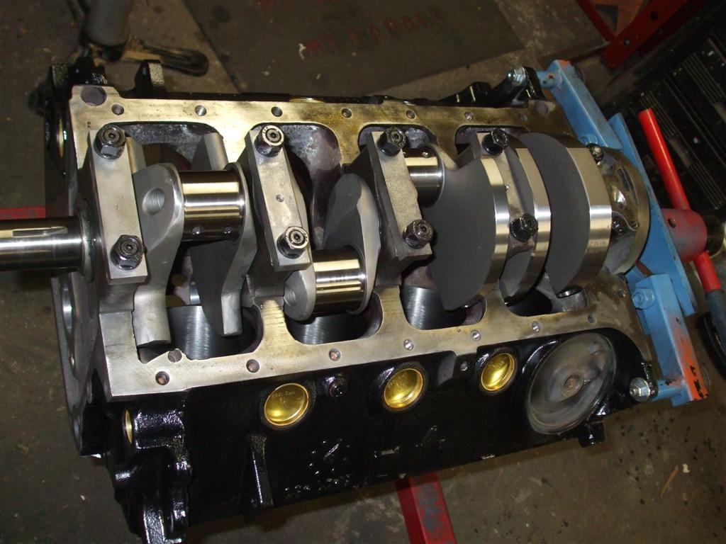

The machine shop was nice enough to duplicate my Rear main cap mods that I did on the other block. The stud hole under the oil pump was spotfaced to allow for a nut thicker than the stock hex cap main bolt.

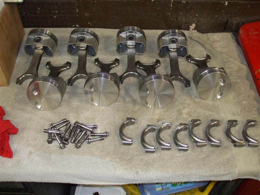

Rods and pistons all cleaned ready to go. Next step is to gap the rings, install them and drop the rods and pistons in. At that point I plan to check the cylinder volume, cc the chambers and determine what we want to do for head gaskets. Then its on to crank scraper fitment and bottom end completion. :cheers My plan was to spend some time in the garage today but my wife wants me to be a little more social especially on Valentines day. I think its in my best interest to cater to her wishes. She is afterall spending most of the day in the kitchen making a nice dinner for tonight. :hungry

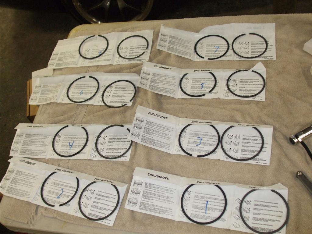

Rings gapped.
.018" top, .022" 2nd

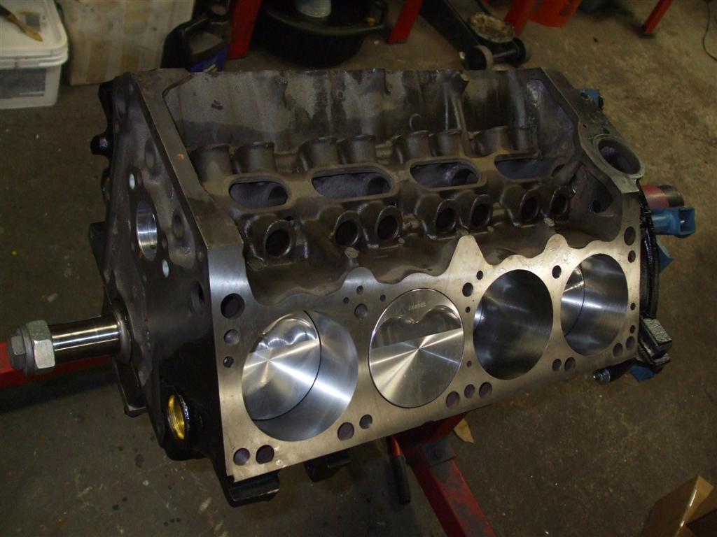

Pistons are in!! Bearing clearances checked out fine.

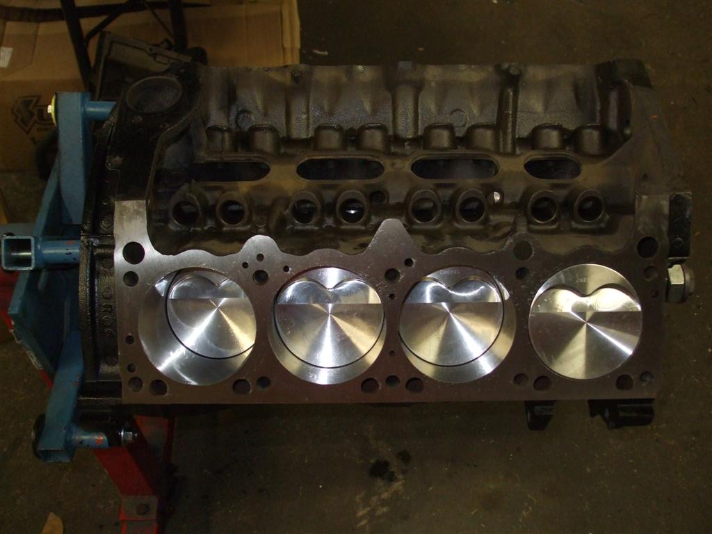

 Post subject: Re: Supercar Smallblock Build
PostPosted: Thu Feb 18, 2010 9:16 pm

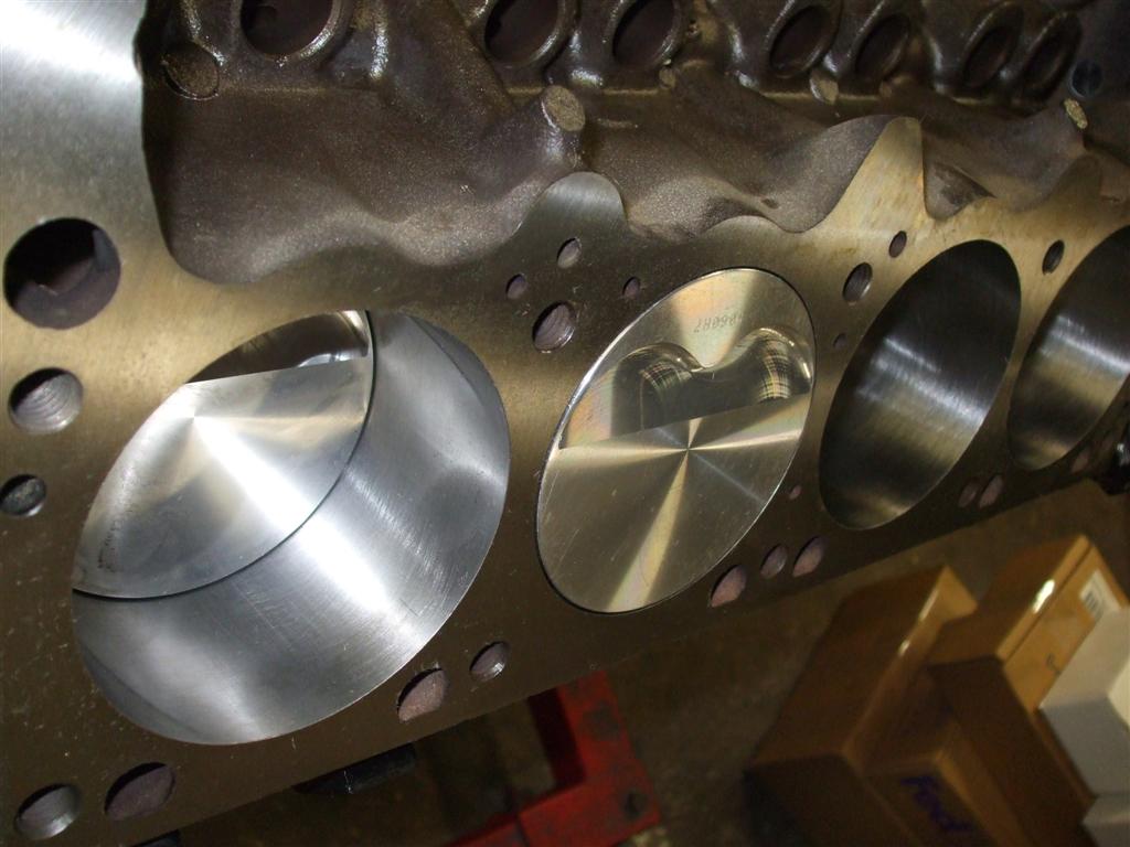

The pistons pop up above the deck. I have to run some calculations to find the static CR. Then we can order head gaskets.

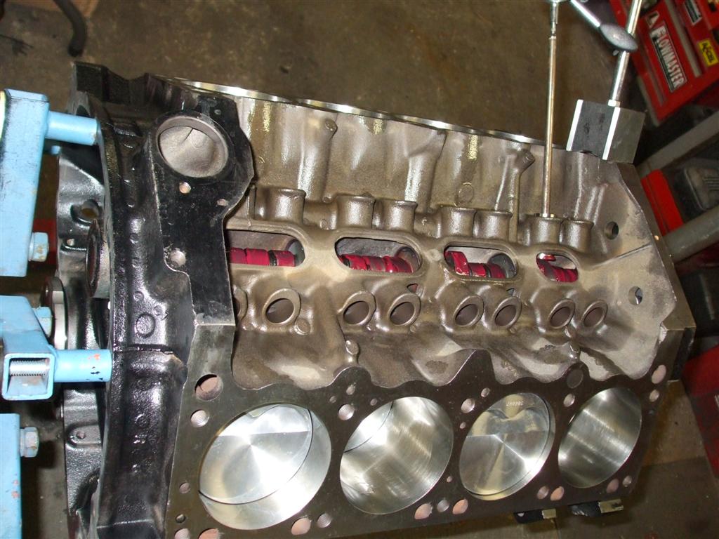

Bottom end is ready for scraper fitment, but first, I want to throw the cam in and degree it so I can install the timing cover. The scrapers overlap the ends of the timing cover and its easier that way.
